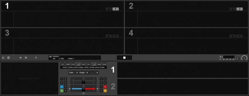

If you want "mix" video between various decks (and not "force" any), you can use the Left/Right Video Crossfader assign buttons (see image)
So, you can force which deck will be set as Left or Right side of the Video crossfader, and when you want to revert to the "automatic" selection (based on which deck is set as LEFT or RIGHT from the decks) you can right-click on those buttons (all should be off when in "auto")
You can also use the following actions (used in those buttons) ...
deck X leftvideo (sets deck X as Left Side of the video crossfader)
deck X rightvideo (sets deck X as Right Side of the video crossfader)
leftvideo 'auto' (sets left side f Video crossfader to "auto")
rightvideo 'auto' (sets right side of the Video Crossfader to "auto")

Yes exactly as your screenshot shows is what I use today.
I am not a huge fan of the default skin though and it seem to be the only one that has this feature on the skin itself. Thats what sparked my initial quesion was wondering if there are any more video friendly skins that have this feature on the skin.
