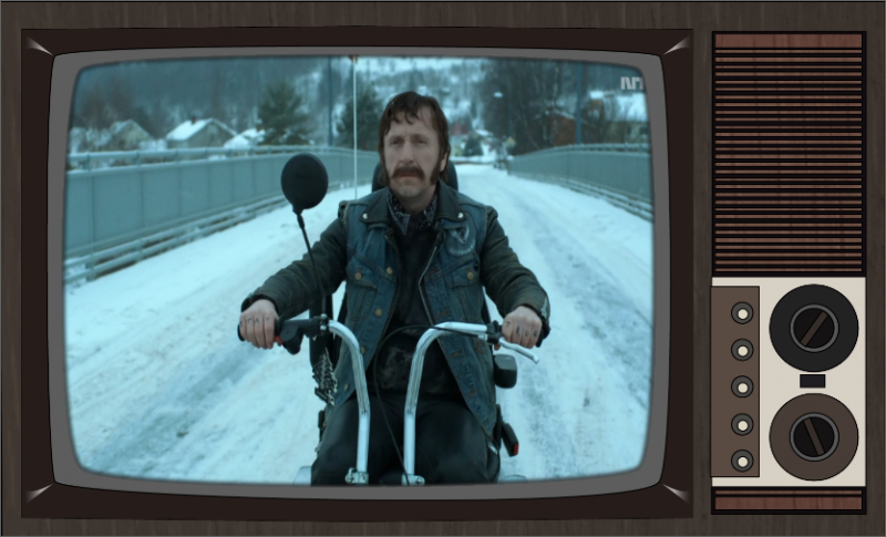

Using TellyVisuals, you could give your older videos a purposeful vintage look with some decorations. This is a single basic panel that uses the VDJ video and an image as an overlay. I adjusted the content rect so the VDJ video fits in the transparent area of the television overlay image. This kind of thing can also help to keep the video nearer it's intended resolution when using a larger screen.
Posted Sat 14 Jan 17 @ 1:22 am
