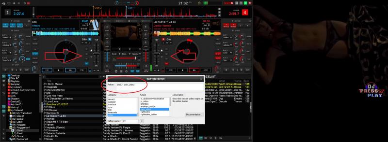

PressNPlayDJ wrote :
i want to have buttons that i will have the option to select which deck will be the video ouput.
deck 1 over_video
deck 2 over_video
deck 3 over_video
deck 4 over_video
This overrides the video output with the output from the specified deck.
Posted Fri 12 Aug 16 @ 9:17 pm

SBDJ wrote :
deck 1 over_video
deck 2 over_video
deck 3 over_video
deck 4 over_video
deck 1 over_video
deck 2 over_video
deck 3 over_video
deck 4 over_video
I just tried it and worked perfect!!!!!!! This is what we were looking for!!!!!!! Great job again Scott!!!!!!!!
