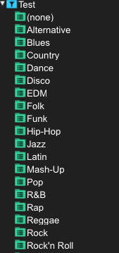

I want to make a filter folder for every genre seperately,that shows the most played songs in that genre
What filter code do i need for this?

Try this one:
group by genre with sort by Play Count Play Count > 0

It doesnt seem to do anything.all im getting is a filter folder with nothing in it.
any other advice anyone?

works fine here?!?

Didnt realize i needed to press the filter folder to see all the genres below it.
I was thinking of making one for each genre but this is a lot easier thanks!
Is there any way i can remove the genres i dont need?

What options do you get if you right click a genre?
right click options are:
-search with geniusdj
-batch and all of its options
i guess the only way to fix it is to change the tags in the songs themselves
wich is too much work for me knowing that i have 300.000 songs

in case you only need a few Genres, then you will need to create separate Filter Folders for them like..
genre="edm" and Play Count >50
