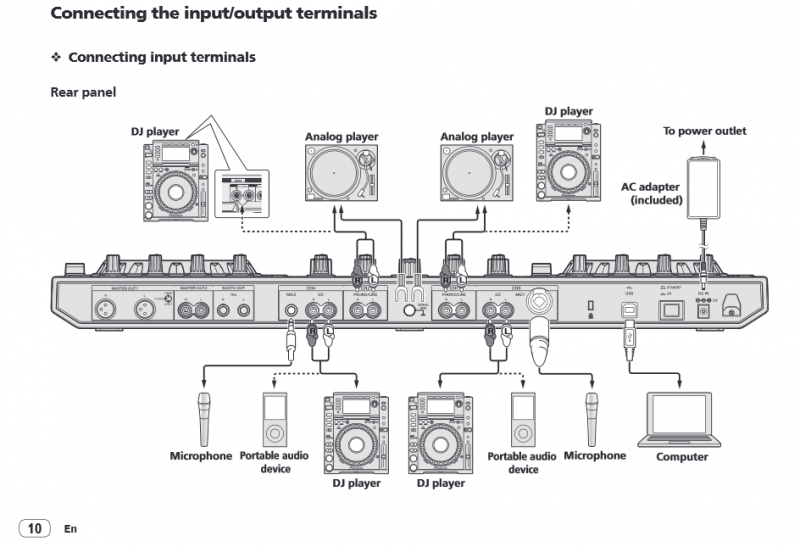

maybe this image from the DDJ-SX manual will help but it would leave out the nexus mixer not sure why you would need 2 mixers anyhow

Yes it is possible, just specify what controller controls what decks (in the Controllers section of options).
No need to even connect the CDJ audio, unless you want it as fallback.
