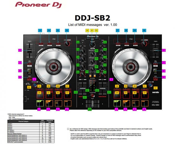

We will contact you guys once we get the unit or at least Pioneer releases the "List of MIDI Messages". Right now, it would take too much effort and time for all of us to try providing support for this unit without any of the above.
Posted Wed 30 Sep 15 @ 9:36 am
This is available on the Pioneer website now:
http://cdn.pioneerdj.com/~/media/pioneerdj/software-info/controller/ddj-sb2/ddj-sb2_list_of_midi_messages_e.pdf?la=en
Posted Wed 30 Sep 15 @ 9:54 am
good catch.. I was trying searching for this from here.. http://www.pioneerdj.com/en/product/controller/ddj-sb2/black/support
Ok will prepare some files and send u guys.
Thanks Keith ;)
Thanks Keith ;)

I already got a DDJ SB2 and hacked the existing mapping files for the DDJ SB to work with that.
Only two small additions were necessary (for the gain/trim controls and the LED vumeters).
As far as I can tell, works without problems.
I am not sure if/how I can post the files here (if it is allowed at all) , please advise.
Posted Sat 03 Oct 15 @ 9:15 pm
As of builds ending at xxxx.1069 (or higher), the Pioneer DDJ-SB2 is natively supported in VirtualDJ 8.
All you have to do is to open VirtualDJ, let it run for a few seconds, and then re-open. Verify the build number from the Settings window.
An Operation manual will be prepared soon, but in the meantime you may also take a look at the DDJ-SB one.
For now, the TRANS PAD mode may not work. We will deal with it when our unit arrives. Special thanks to the users who provided useful feedback for us.
