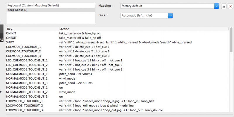

Hi. I bought a Korg Kaoss Dj Controller.
Please help me with the SHIFT button.
It doesn't work.
I'd like to use SHIFT+BROWSER, SHIFT+HOT CUE (delete cue point).
What is the mapping?
Thanks.

Those should be working already with the factory default mapping
Shift+ TouchButtons should delete the Hotcues if the Pads are in HotCue mode
and SHIFT+Browse should cycle focus through Browser windows

Thanks for the answer but unfortunately in doesn't work :(
this is my mapping
this is my mapping

What keys do you get at the bottom-left (Key Learn) when SHIFT + HOTCUE buttons are pressed ?
Do you see ...
SHIFT
CUEMODE_TOUCHBUT 1
EDIT. Ahh i see, probably the SHIFT+BUTtons have separate Midi note, so probably you only see SHIFT in the Key Lean, will take a look and fix for the next build.

If a hotcue is assigned (e.g. Hotcue 1), do you still see the LED of the HC1 button turned on while SHIFT is pressed or does it turn off while SHIFT is pressed and turns on again when released ?

Thanks again for helping me.
when I press SHIFT and then HOT CUE 1/2/3 I only see SHIFT
when I press SHIFT, the active HOT CUE BUTTON(S) is flashing on my controller
Posted Wed 11 May 16 @ 11:00 am
Ok mapping files fixed for the next update (whenever it comes)
