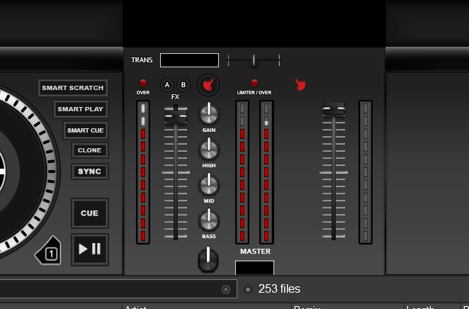

One last thing with volume. What's the trick to only show a fully lit LED? Currently, when the levels bounce, each individual LED is lit from the bottom up. I would like the individual LED to be lit all at one or not at all.
Am I asking correctly?

Working on a highly simplified, but detailed version of the NS7II.

hmm u may need to define each "Led" as a separate button (or visual) and use something like ..
get_vu_meter 'master' & param_bigger 40% ? param_smaller 50% ? on : off : off
this will turn on a "Led" if the VU meter is between 40% and 50%
EDIT.. probably you need all Leds below to light up so the actions should look like..
get_vu_meter 'master' & param_bigger 40% ? param_smaller 50% ? off : on : off
Will light up the xth led if VU is over 50%

So I used your suggestion and it worked on the master VU left... But having headaches trying to figure out to group everything so that I can easily replicate the work i've done, and just re-position 36 pixels to the right using a few lines of code.
I've look at so many example and getting super confused. I have defined the following:

But do I have to copy and paste everything in the original group? or can I define what a group is like define class?
Posted Fri 20 Feb 15 @ 9:09 am
I guess in other words, can I define a group and just use the class id of the group for an element so that I can duplicate the group in another spot without having to redefine everything inside? I am trying to shorten the amount of code used since I need to do this a lot.
Posted Fri 20 Feb 15 @ 12:46 pm

I don't know...
I tried the following:
<visual type="custom" source="get_vu_meter_left 'master'" orientation="vertical">
<size width="8" height="196"/>
<pos x="939" y="440"/>
<down x="60" y="2102" nb="11" smooth="false" />
</visual>
It's not the same effect. All LEDs come on and sort of move horizontal, not vertical.
</visual>
