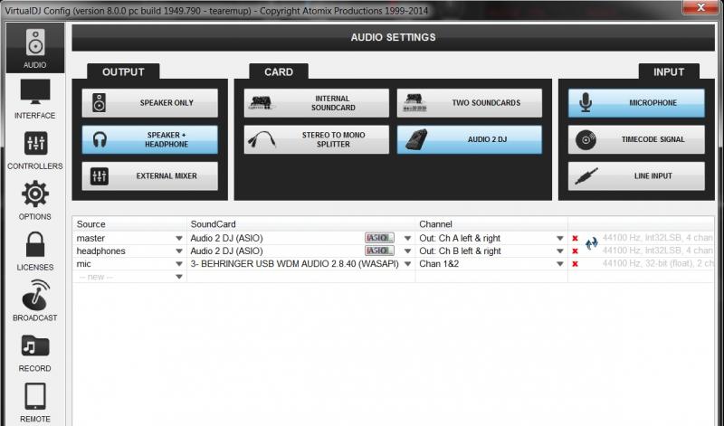

You must first, set up the mic in the Windows system. Then, you must then select the input in v8's audio set up.
