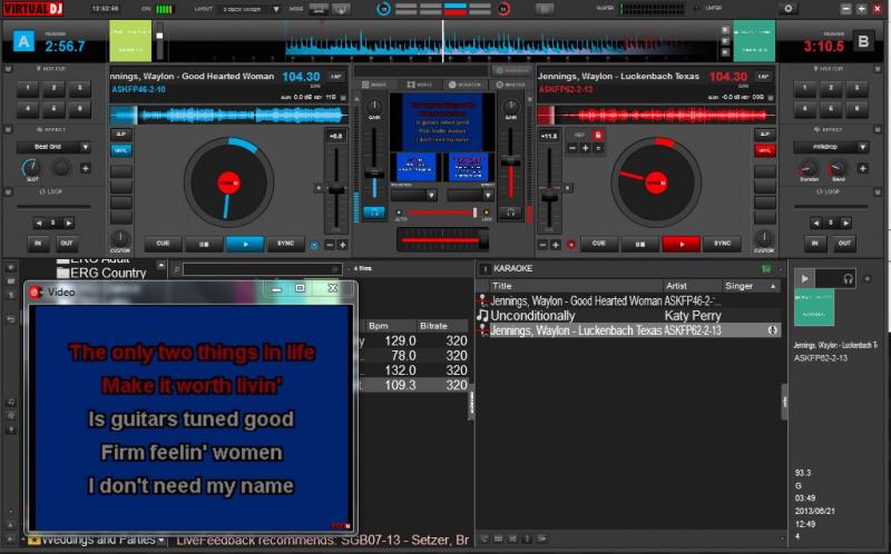

Hello my karaoke main video seems to be stuck on the VDJ8 logo picture, the karaoke songs play and the videos for the decks show in the small preview screens but the main output will not show the videos. Deck A the graphics will play but in Deck B no dice. What am I missing? I'm sure its something easy I dont see :)

The Video for Deck B still does not come through on main output screen when I done as you suggested.

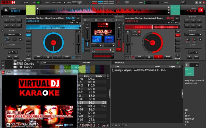

However when I play a karaoke track on Deck A then fade to Deck B and press play on a karaoke track the main video output for Deck B will show up!

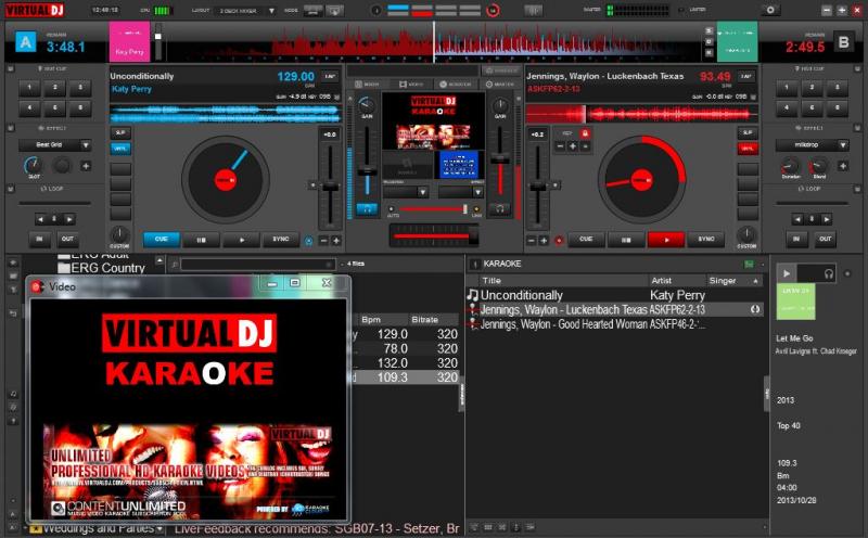

Are you manually loading the tracks into deck B or is the Karaoke Automixer loading them?
Looks to be like you are loading them and Karaoke is running from deck A.
