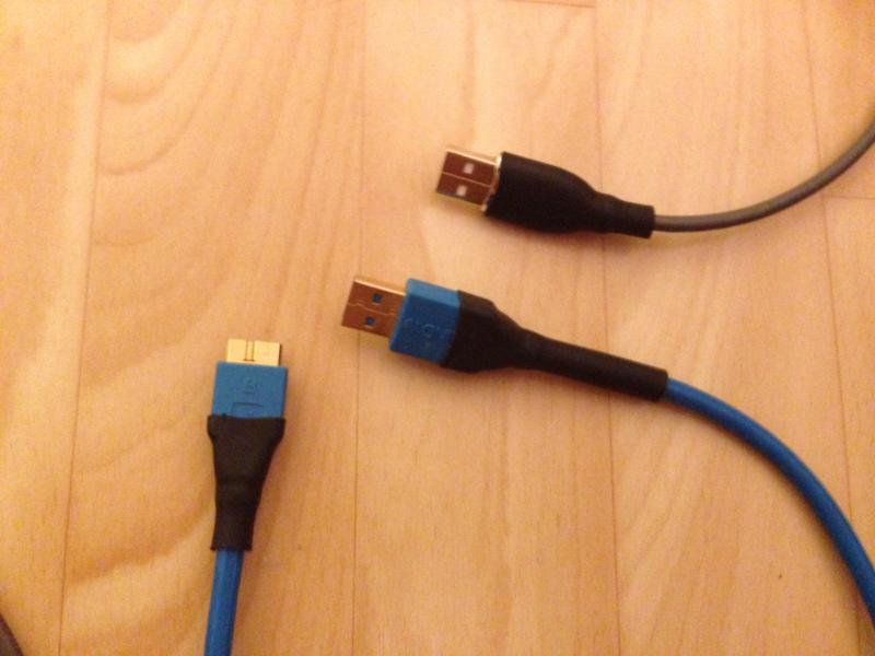

I tend to get the right lengths I need, i.e. 0.5m, 1m etc and heat shrink the ends.
18mm 3:1 is what I use but if you can get 18mm 4:1 even better, do not get adhesive/glue heatshrink.
Posted Wed 14 May 14 @ 6:40 pm
These are USB conductor digital audio cables right? I like how you protect the connector part with the tape.

Haha, just had a look at that weblink - what a load of techno-babble. While it's true that RF can potentially mess with a digital signal, you'd need a LOT of it. Even cheapo leads are screened, and I can't see there being much of a voltage drop issue over a measly metre of cable. What a rip. Liking the heatshrink idea though, it'll make the cable live longer for sure - if a wire is going to break, it'll always be where it meets the plug.

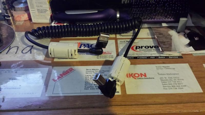

I use some of these. They pivot 360 degrees at both ends. I purchased four of them. I haven't been able to find them in a couple of years now though. I also put on ferrite cores, to reduce signal hum from nearby electronics.

Lol, thats heat shrink.
