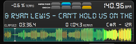

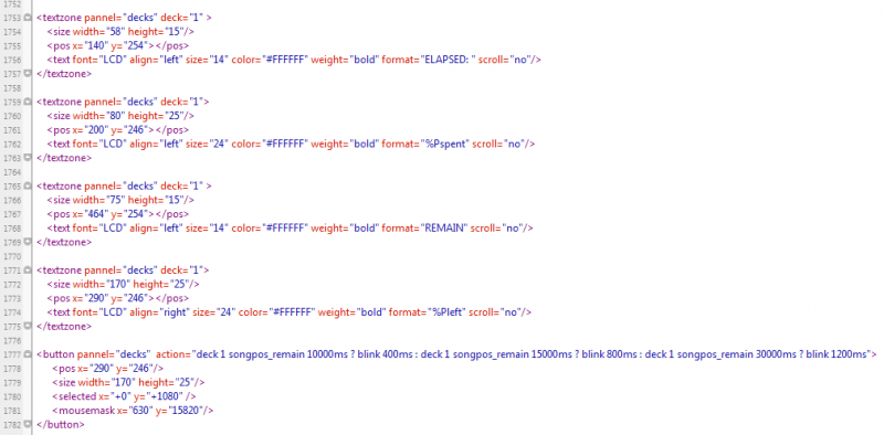

Anybody can see what is wrong here.
Elapsed time is not working
Remain time works perfect
Even if I replace Pspent into Pleft, time doesn\'t change either, while the remain part is working fine.

There is nothing wrong with the above code.
Most likely the textzones that dont work, are in the same area in yoru screen with another songpos element.
If another songpos element (even if its in another panel) are in the same are with textzones, then they dont get refreshed
Just make sure, songpos elements are displayed always in the same position, or not having textzones in those areas.

Djdad,
Thanks for the tip, indeed this was the problem.
Now it's working fine.

Don't look any further, I also found my mistakes.
