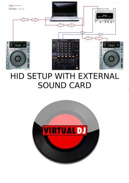

Thanks GroovinDJ but out of curiosity i would really like to know how the config is done for the setup on this link http://www.virtualdj.com/image/4505/63811/SETUP2.jpg
Because if im using the CDJs in HID mode and not the mixer as well how will i do video transitions? Thats why im curious about the setup shown on the link above. If you can assist by showing me the config for that HID setup with External Mixer(with soundcard) id be greatful.

The setup pictured is a bit pointless in my opinion because you have sound cards in both CDJs and in your mixer, so the external sound card is not required.
To use your crossfader for video, you'll need to take a look at your DJM900 manual and investigate the MIDI side of things.
The mixer has a traditional 5 pin DIN MIDI connection on the back, as well as the USB connection on the top, so the manual should explain which you need to use (may be poss to use either) in order to map the crossfader to perform video transitions in VDJ.
