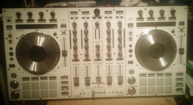

A breve un nuovo gioiellino ...
Posted Sat 13 Apr 13 @ 10:46 pm
white edition :-)
Posted Sun 14 Apr 13 @ 9:57 am
