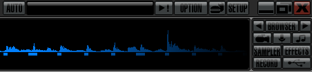

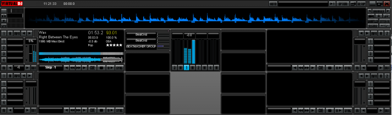

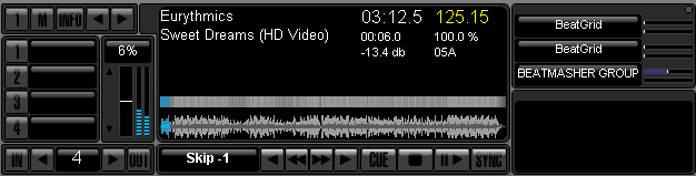

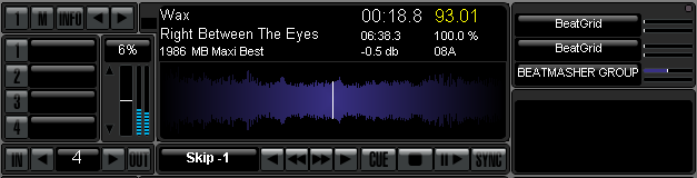

Hi out there,
working on something new:
This skin will have some pannels/deck:
and some small/deck:
samples:
cbg-detail-edit:
3fx/deck:
scratch/Video also...
another detail:
Music/Karaoke/Video-Seperator, get food, different font-sizes, sep. auto-mix-section...
Hope I can finish this soon.
