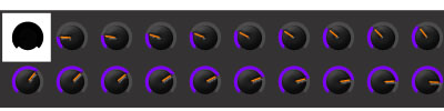

I have almost finished drawing the elements for my 2 deck skin but I just checked a few existing skins and they all had the edges of the different images touching... unfortunately I didn't factor this in during designing. what I have done is make center to center 40 pixels, giving each image a radius of 20 pixels. I have tried to put them all together as I have seen but they dont equal an exact pixel in radius, meaning they might wobble or take up too much space to allow other controls.
Is it possible to use a clip mask to cut out the area in between but still say the radius is 20 pixels :) or will I have to redraw the knobs :(

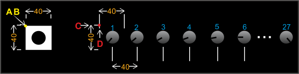

All you need is the proper clipmask ...
If your knobs are in more than 1 line, modify the <fader> line as ..
<pos x="C" y="D" nbx="E" nb="27" smooth="true"/>
where E is the number of knobs in the first line (and each line must have the same number of knobs, except the last one).
<slider action="deck 1 effect slider 1" orientation="round" >
<pos x="32" y="272"/>
<size width="40" height="40"/>
<clipmask x="A" y="B"/>
<fader>
<pos x="C" y="D" nb="27" smooth="true"/>
</fader>
</slider>
