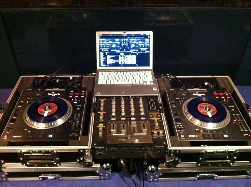

This is my VDJ audio setup. This particular mixer doesn't have midi capability. I also have the NS6 what I use for video. I'm waiting for Numark to unleash a new mixer along the lines of the unreleased Numark X7 mixer.

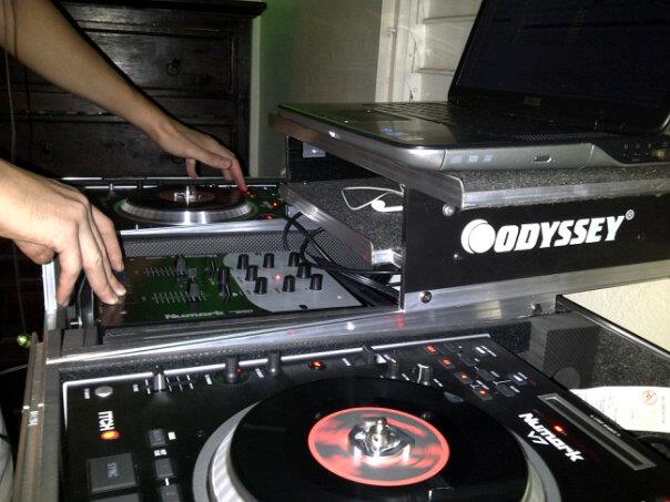

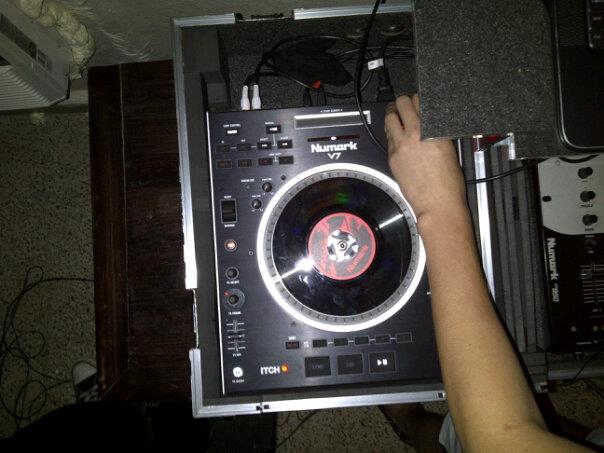

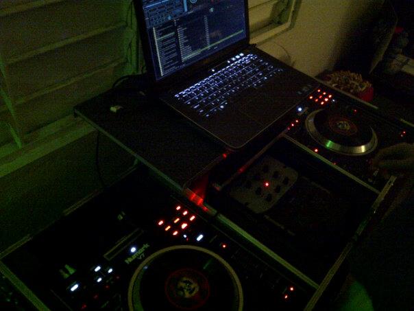

So I've developed a fetish for these things. A V7 Fetish. Not in the sick kind of thought pattern but rather simply admiring the structure of the device/turntable itself. Passing your fingers gently over its metallic casing inspires a type of self awareness that makes one realize the impact your about to make with the following equipment whether it be out in the club or a hardcore electro rave in your bedroom.
The casing is very important for it has become their home. Where they rest and nurture of comfort. They basically sleep there.
I can play blind folded. Making loops on the fly makes me want to cry...
So yeah....I like to dj and stuff.
