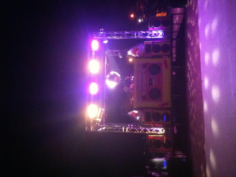

Great comments here on the thread. I ended up using 2 Lekos, but really could have used a 3rd or 4th. The setup wars pretty dope, 2 ft stage, 12 ft vertical truss, 16 ft wide, and 12 ft deep. 16 color kinetics on the top of the rig, a few truss warmers, and a 36\" mirror ball.. The pic is from my phone, I\'ll try and upload a better qwuality later for what it\'s worth.
I still agree that a moving head or scanner would have a better look, but as stated before, no in the clients budget.
It was a pretty phat party...2000 of Montauk\'s finest. Movie stars, celebrities, and most importantly, Victoria Secrets models! Unfortunately, I was just the production company, not the DJ!
