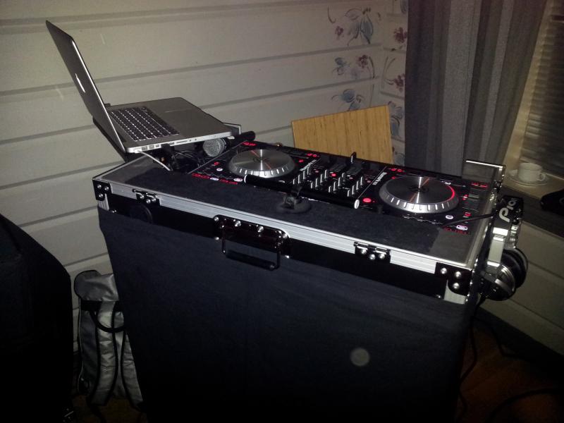

I,m using Macbook Pro i7, 2.2ghz with OSX Lion, everything working perfect.
4-7% CPU when playing, 12-18% CPU when loading

Off Topic: jjloevli where did you get that light that you are using on your coffin. It looks bright as HELL! That could be a pretty cool tool to have in some of the dark venues for sure.
