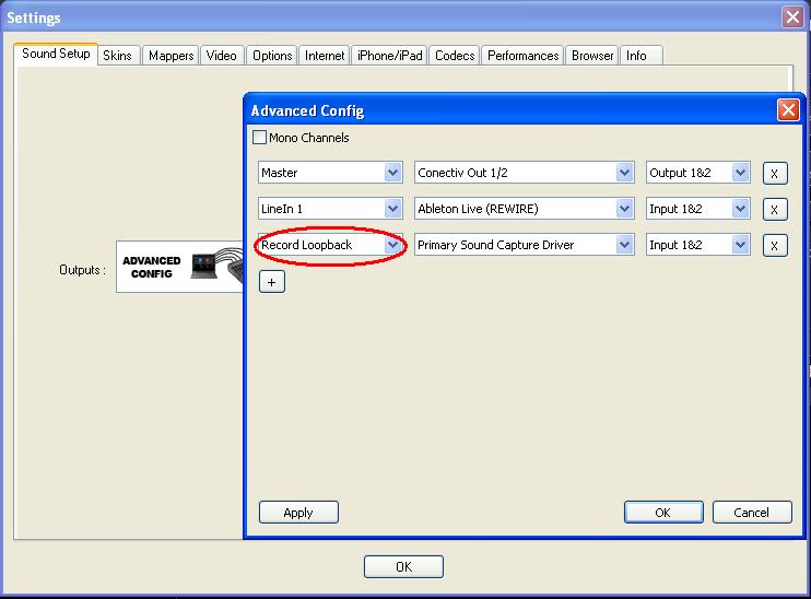

you need to make sure you have set a record loopback in advanced config then select your input source as primary sound capture driver, if your using the mic/line input on your computer to record, if it is an external soundcard choose that instead. Then just config the recording how you want it and where you want it to go, then just press record and start your mix. You can use other programs to record, personally I use Audition, but in all the programs you need to route the input into the program, vdj is no different.
Posted Fri 20 May 11 @ 3:58 am

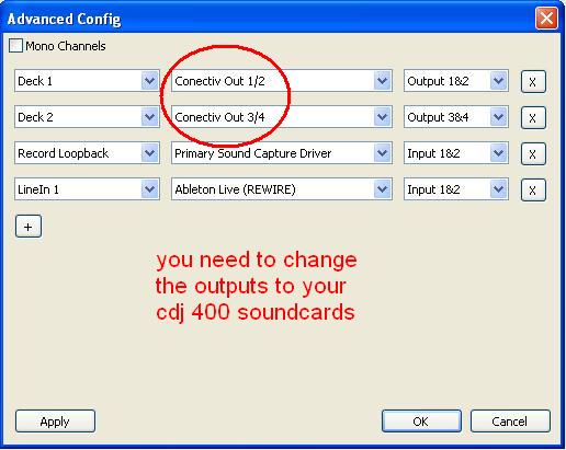

Two Cdj 400s, djm 400 mixer, krk monitor is my set up. I downloaded the drivers from pioneer for the 400, I have a line in on my computer coming from the second set of rca on the 400 mixer. How should my settings go. A pic like the last one would be great. Even a simple tutorial
Posted Mon 23 May 11 @ 1:21 am
Sorry I haven't got cdj's to show you but when doing advanced config you need to configure all the ins and outs. Once that is done just switch the cdj to midi and it should work. For the 'record loopback' either feed the master or record from the djm back into vdj using a dual rca to headphone adapter
Posted Mon 23 May 11 @ 2:59 am
