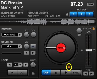

Yes - now that you mention it, I did have BEATLOCK mapped to the keyboar "X" key, and that's what I used to sync. So now I guess my question really is: What's the difference between SYNC and BEATLOCK?
What I want is to PLAY and SYNC simultaneously, but only if I've pre-selected the SYNC button.
Posted Tue 17 May 11 @ 5:29 pm
then you want smart play, just press the lock, it will sync, beatlock and play when you press play if smart play is selected.
Sync and beatlock are pretty much the same thing, they will sync to track to the nearest beat on the cbg, but beatlock will only follow the grid (which can be wrong) whereas sync if the track is stopped will match the bpm allowing you to drop the track wherever you like not locked to the grid

OK great. So it sounds like I need to use the mapper to set the script on my Denon PLAY button to Smart_Play. I did this, and now the PLAY button on the Denon does not play or do anything at all. Am I missing something?
Posted Tue 17 May 11 @ 10:13 pm
smart_play is like a shift button so it has to be separate to the play button, if smart_play is active it will make "play" do three things... play, sync & beatlock, if smart_play isn't active "play" will just play the track
you could use something like this for the sync button on your controller.
holding 2000ms ? deck 1 smart_play : deck 1 sync
If you press the button it will sync the track, but if you hold the button for 2 seconds then release it will activate smart_play.

I'm looking at the Denon mapper in VDJ and for the SYNC key (there is only one) the default action is:
var '$shift' ? masterdeck : sync
So would I replace this text? Or would I add second new action to the sync key?
What exactly would I type if I wanted the smart play to engage only if I held down the SYNC key say for 500ms?

Hope I did not give the wrong impression. As I have stated before, I use the sync button all the time. I use it to match the bpms, that's it. I don't look at the beat grid or what ever you call it. I mix by ear. I have seen the wave forms, and to me they don't match up to mix by sight. For a guy that has been using this software for a long time, I am not familiar with a lot of the functions. I can't even find a beat lock button on the software. I am also very simple, and got this software to be able to carry every song I own, and to do video. I use loops, audio and visual effects, samples, and plenty of tricks I learned back in the loin cloth days. I will now try some of these tricks from this thread and see if they can enhance my performance.
OK, just found the beat lock tab, and tried it. I don't get it. Tried the smart play tab, not for me. Not sure what the smart cue does. I use the key-lock all the time, so know what that is. Even though I have no use for these things, I am sure others do.

holding ? deck 1 smart_play : deck 1 sync
The default for holding is 500ms
Posted Wed 18 May 11 @ 4:37 pm
OK so is this script IN ADDITION to the existing script as a new action? Or should this script replace the existing script for the SYNC button?
And should I duplicate it for deck 2? The mapper has only one SYNC key.
Posted Wed 18 May 11 @ 5:11 pm
I would just replace the existing script, masterdeck makes the selected deck the one that all other decks sync to, It's not really needed
