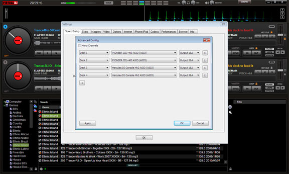

when you reach here
just add deck 3 and deck 4 too, but make deck 3 output 1&2 and deck 4 output 3&4
adding again the Pioneer CDJ ASIO (ASIO)

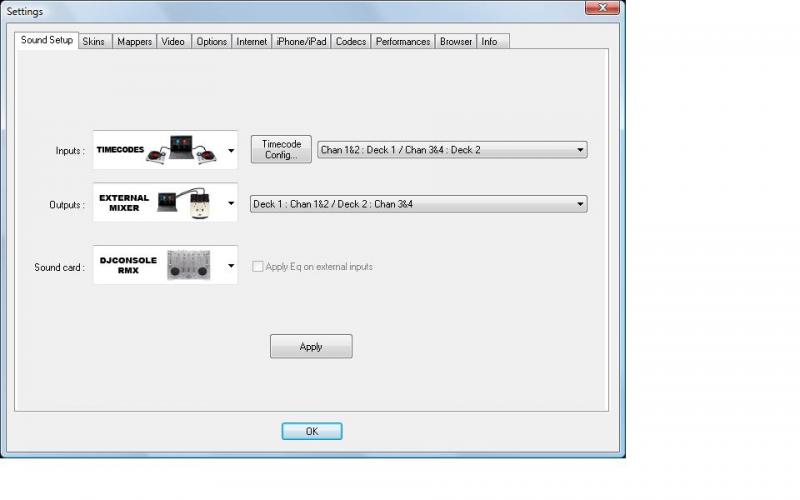

My setup:
Windows 32bit OS
Hercules RMX timecode ASIO
Would like to set up 4 decks adding the Numark DMC2 controller as virtual decks 3 & 4 (which I now have working as such)
I also have the Numark dm950 USB mixer with built-in 2 channel soundcard to use as output for decks 3 & 4.
this is my working configuration now
but when I attempt this new configuration:
I get this message:
So it doesn't seem to be as simple as adding decks to ADVANCED configuration.
What am I missing?

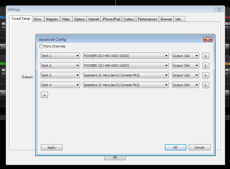

Thanks for the reply guys...
I tried the settings as below
Deck 1 . Cdj 400 driver . Output 1&2
Deck 2 . Cdj400 driver . Output 3&4
Deck 3 . Cdj400 driver . Output 1&2
Deck 4 . Cdj400 driver . Output 3&4
And it works... however of course is using the cdj drivers and so it also borrows the same channel in my external mixer... I need to route every deck and assign it to a channel in my mixer ddm 4000 so I connected my old mk2 and assigned it to control deck 3 and 4... succesfully. However I get no sound.... here is what I am trying...
then VDJ CRASHES... and i have to restart my PC.
any ideas? am i doing something terribly wrong?

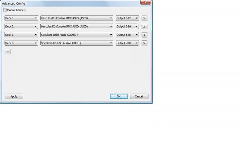

Change te output of deck 3 to ch5&6 and the output of deck 4 to ch 7&8.
If in your mixer the decks come on a different channel just play a bit with the outputs

i tried changing them to 5&6 and 7&8 and CRASHED :((
anyone with a similar set up that can help?

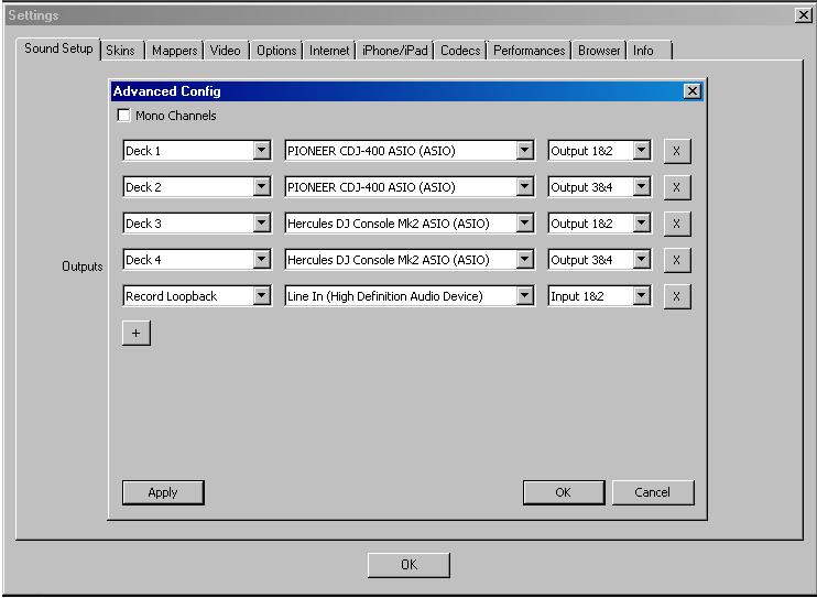

I\'m using 2xcdj-400 and mk2 for 4 decks setup. Here\'s how I got it set up. It works, although sometimes there could be some crackling, clicking on apply will take the crackling away.

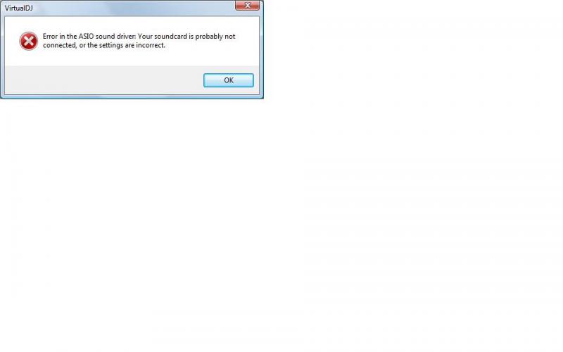

sup guys...
so i tried the settings just as you told me and the good thing is that the software is not crashing, but still not working... here are the screen shots...
when i click ok i get the following error...
Error in the asio sound driver your sound card its probably not connected or the settings are incorrect... :((

Hei!
Take into account that I am using a 4 channel mixer, that's why I set it up like that...
Try setting both cards' asio buffer size to the same number, from their own settings utility. Start with a bigger number to avoid skipping.
I was talking to a vdj tester, and he did not recommended me this configuration, as using two different asio drivers from two different brands is too heavy for the software.
At this point, I'm having problems with pioneer asio drivers (while using the 4 channels setup), so I gave up, and right now I'm back spinning with 2 decks.
