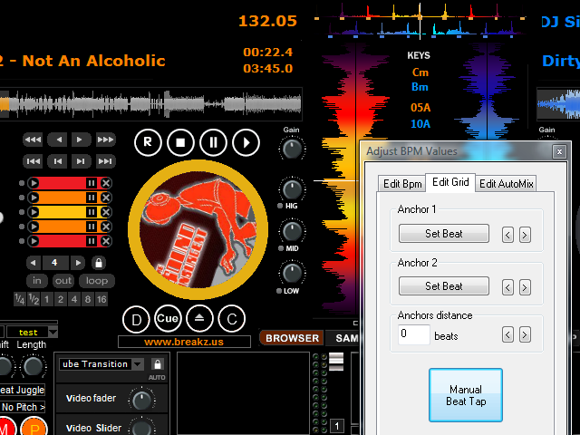

I\'m gonna assume your only using a laptop, NO turntables, no CDJ\'s?? Anyways if you right-click on the BPM (depending on what skin your using) a box will pop-up.
Click on the tab that says "Edit Grid". Those little boxes is what VDJ lines up when you press sync (cheater, lol) but you would have to go through and edit all the tracks that dont line up, but after you did that you shouldnt have any problem. I'm pretty sure thats how it works so just try it and let us know if that worked for you.
Hope I was some help
Huey
