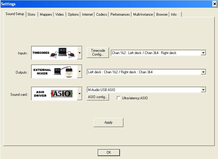

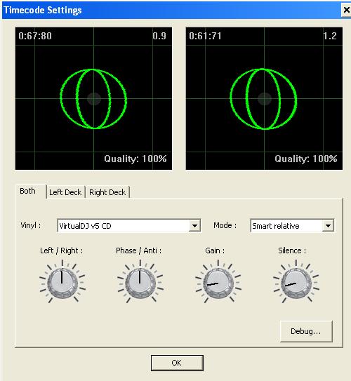

This is how I have it set up.

thanks for you help. Sicwax is made for serato as well so I think its not the vinyl problem but config. could you show me the advance settings for your time code config? and are you using cdj or vinyls and whats your set up?
And do you set it to phono or line? Mine's set to phono. and what version of vdj are you using?
Maybe is the mode which i have to set up to smart relative which helps the time code to 'learn' the config for it because auto config doesnt help as every time code is different? thats what I heard. Thanks.

Reset all your settings to factory default, and then set up torq just how I have it on the screen shots. I was having a similar problem until I reset virtual dj to factory default and then I was able to get it to work.
I use both cdj and vinyl and I haven't had any issues with the needle drop, so try using my settings, it might just work.

Yes. I am using the Torq Vinyl with the Connectiv interface.
I could not get the vinyl to work correctly with the "torq" setting.
I used the "mixvibes dvs v2" setting with the Torq vinyl and then used the timecode debug feature to fine tune and it worked.
Although my time code visual of the green circle is not as clean as some of the screen shots I've viewed from others.
Another trick I found helpful was when you are in the CONFIG mode and have the "Settings" window open, going to the "INFO" tab allows you to "reset to factory settings". This is very helpful when you are continually playing with the settings.
Once you get it working I advise "saving the setting"
I tried several times to use the "torq" setting but it does not work with the torq vinyl.
I'll post screenshots of my timecode view later.
Here are a few links to help you out.... the one about timecodes explains how they should be set up.
Hopefully this helps.
