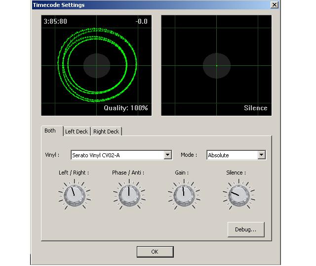

Hi guys i have been reading the Timecode Configuration Guide in the wiki and i cannot seem to get my pitch within the config to stay at 0.0 neither can i get 4 lines of seperate dots.
The Timecode Configuration Guide tells you a bit about setting this up correctly but the settings i change do not make any difference.
Also my Timecode config looks different to the picture in the Timecode Configuration Guide could this be my problem
I am using the esi maya44 usb along with serato CV02 Timcode Vinyls..
The pitch will always got somewhere between -1.0% to 1.0%
Here are my screen shots.

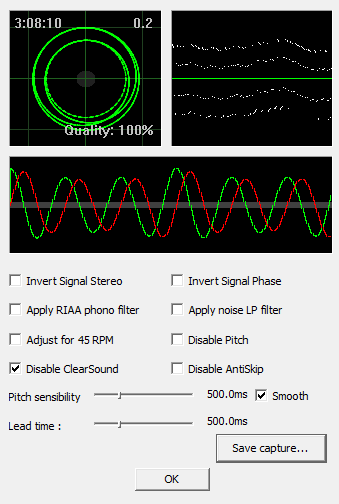

And this is how they surpose to look according to th timecode config guide.

According to the Timecode Configuration Guide the noisemap is a vinyl timecode picture and a cd timecode has a complete different signal shape.
The point i am getting at is my signals are nothing like the ones in the guide.
1. The circles green in colour for the timcode signal. Where the circles join mine join in the top left box (See pic below)
But the timcode signal from the Timecode Configuration Guide show the same signal but the circles join in the bottom right box (See pic below)
Is this a problem or a setup error by myself.
2. The lines within debug menu state in Timecode Configuration Guide that you shoud have four seperate lines of dots 2 above green line and 2 below green line.
I have dots all over the place (See pic below)
But Timecode Configuration Guide shows the dots should be like this
Same again is there a problem or is it a setup error by myself.

Your circle is slighty off
Posted Sun 06 Dec 09 @ 6:10 pm
So how do i correct it then.

Posted Sun 06 Dec 09 @ 6:41 pm
In the first screen shot. Turn the left/Right & Phase/Anti. These will allow you get a perfect t shape. Alittle off from perfect is ok. Just make shure that you have 100% time code quality. The dot that's inside the green circle is the silence. On my laptop, the dot is smaller. Turn the Silence knob back to make it smaller. Uncheck the clear sound & un check the smooth.
Posted Sun 06 Dec 09 @ 9:44 pm

Your screen shots show a good config.
You do have the four streams of dots, and they do not cross the middle line, which is the most important. We don't care if the two upper streams or two lower merge sometimes.
We also don't care about where the circles meet.
So, from your screenshots, it looks like you'll have a good and strong timecode detection.
The thing that you could tweak are:
1) Your silence knob is probably a little too high. Put your turntable on stop, and lower your silence knob until the gray area covers the green signal, but not too much bigger.
2) You say you use turntables with a maya44. Do your turntables have line-level outputs? If not, turn on the "riaa filter", it would probably help.
3) Your circles are just slightly egg-shaped. Moving the left/right knob just a little could help. But it's almost ok already. Don't touch the phase/anti, you don't have this problem.
About your pitch variations, it doesn't seem it's coming from the timecode. What turntable are you using? If it's a belt-drive, try to change the belt. (if you did need the riaa filter, fixing it might help too).
