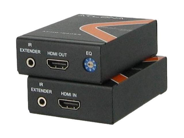

Daz don't sweat it its just drive by Phil. I've been doing this av thing for over 20 years if we talking about hdmi 1.3 spec however we just got 1.4 in May which increases the bandwidth from 165 mhz to 340 mhz adds some cool things like Ethernet connectivity and a modest res bump to 2k x 4k.
but rather then argue on who is right and who is wrong lets actually give the orginal poster something he can use to fix his problem.
something like this would work
as stated before and this time i'm going to put it in caps
VGA IS YOUR BEST BET FOR RUNS OVER 50 FEET
unless you like spending 100's on silly adapters like the one pictured above.

Sure he could get something like this
but it will still be cheaper by far just to buy the 100 foot vga

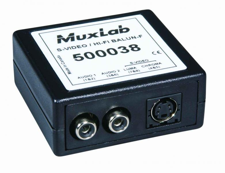

I have S-Video+Audio Baluns that use Ethernet as the middle between the Baluns. You then make or get a 100\' Ethernet cable. I have used it over 250\' with no problem but it says it can go up to 1000\'. Works great even though it is standard def but it is better than nothing.
You can get two for under $100
http://www.svideo.com/500038.html
