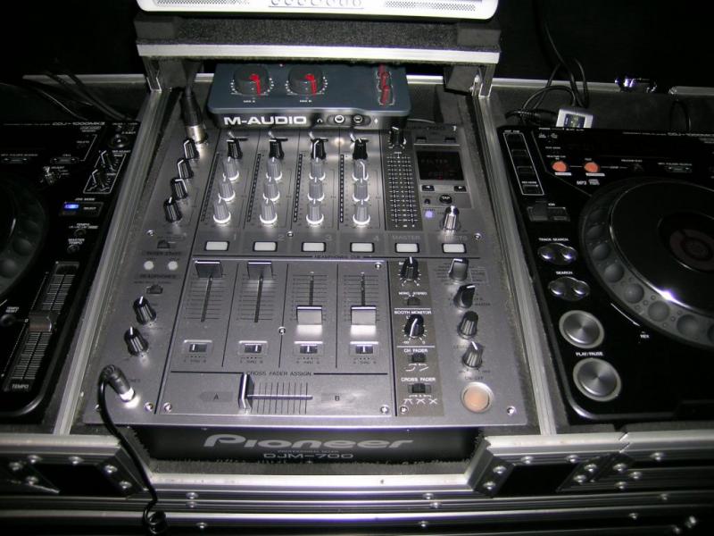

Yo SBDJ I need your advise.
Posted Mon 28 Sep 09 @ 11:48 pm
Nice setup DJPR1, lol!!
If you're using multi-instance, you can use the two sound cards, both in external mixer mode to the DJM-700 and mix all 4 channels on it using it's audio mixer functionality.
It's MIDI functionality will only work in one instance of VDJ however.
