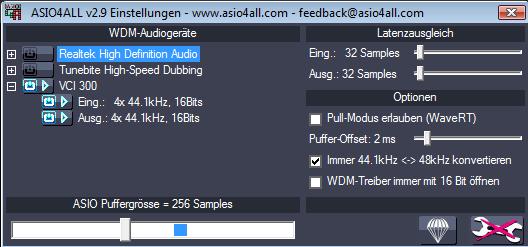

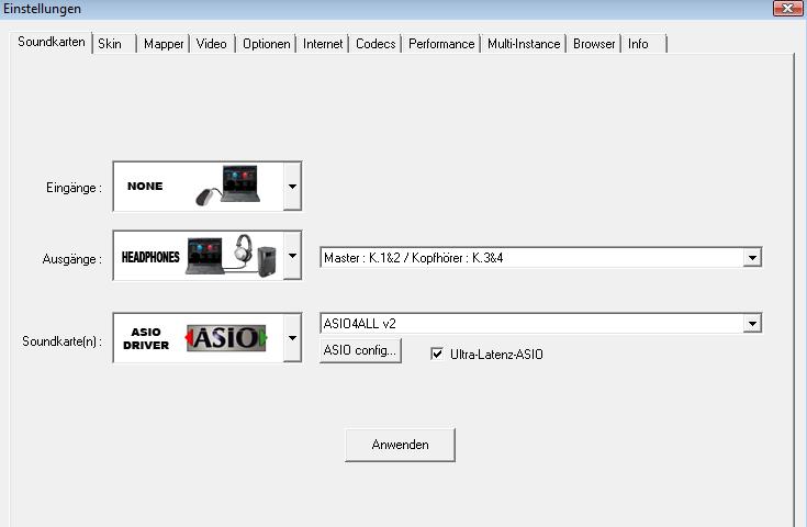

please try this setting
i use asio4all 2.9 , everything works very well with these settings.
