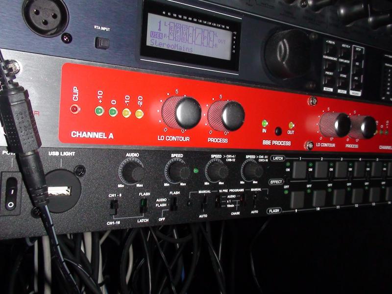

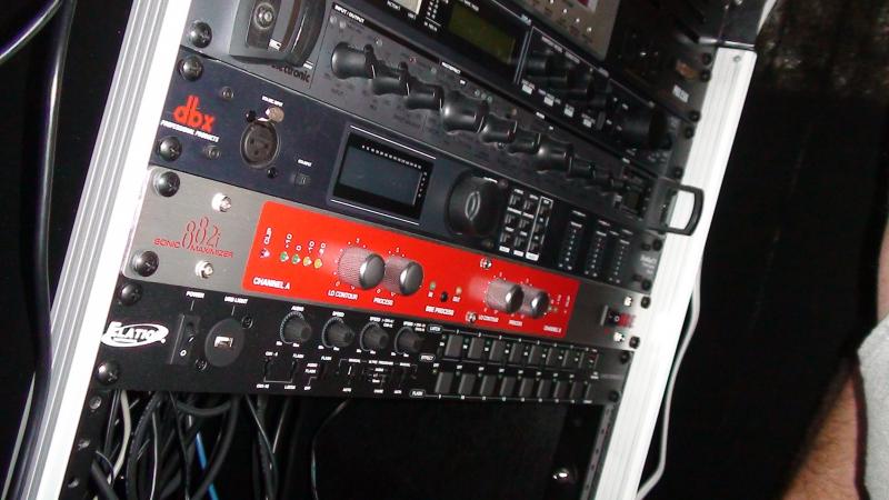

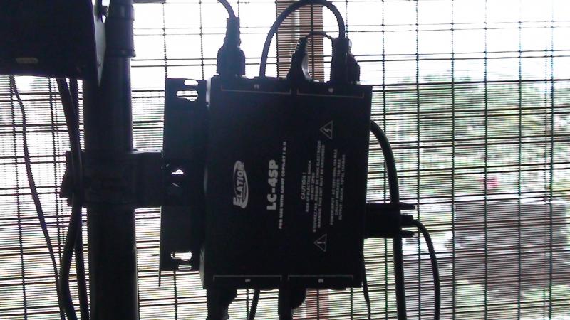

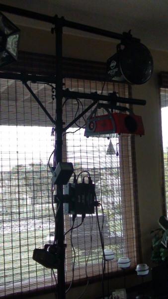

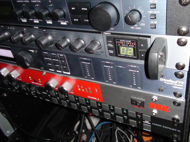

I use an Elation CoPilot III for remote controlling my lights as well as providing power to my truss.
Here are a couple of pix...
As you can see I don\'t have the truss set up in my studio. I have a single light pole setup here but normally this controller/power box for the copilot will mount on each crank stand of my truss. The CoPilot III comes with 2 of these LC-4SP boxes, each gets mounted on the cranks stands of each side like shown here.
Here is a closeup of one of the LC-4SPs.
And here area couple shots of the Elation CoPilot III rack-mounted control unit in my rack.
