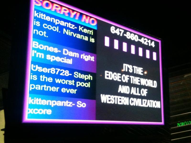

I use the playlist assigned to deck 2. I load it with a dozen or more tunes/videos and run automix mode. As a singer puts in a requests, I place it to the next position so it cues up. Set the mix to 2 secs, set the automix to (remove silence). If the singer is not ready to go you just let the song roll. If the singer is prompt in getting to the mic, double click the karaoke track and it will play immediately. You will always have tunes ready and always have the option to bump a song down the list if needed. You can use the TEXT plugin to put names on screen. I have purchsed the Pangolin texting product and it has changed many things I do now. My screen now looks like this.
