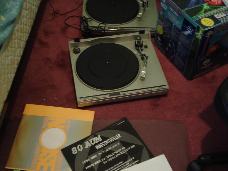

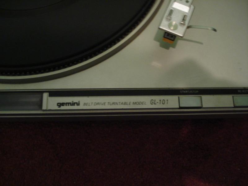

Hello everyone, i posted a thread couple of days ago about the turntable and been wanting to have a TT... I've been looking at craiglist and so far no luck on technic 1200 series. I called my uncle yesterday, because he used to DJ back in his days. We had a conversation and it goes llike this..
Me: Hey uncle what going on? i'm just wondering wheres your dj system and whats your TT? (before he even said the brand of his TT)
Uncle: Well my TT is not Technic, because those are the best...I have a gemini... back in the 80s gemini was the bomb then the technic took over..but its in the attic you can get if you want i have tons of crates with music, you can have it or give it to someone...
Me: cool thanx...ill pick it up tom...(i picked it up today damn it was hot in the attic and some of the outside wire kinda melted).
the only porblem i have is that in dont know if its still working..i plugged it in and it did turn ON and the turntable was moving and still has the needle attached...
To techninc users ill give you guys some props, even my uncle recomended it...WOW..anyway i dont know how to use a TT and wondering if anyone here can guide me to the connection and needles and etc...pls help me out..my set up is just RMX and B52 matrix..i wanted to add "my" TT now to this set up..ill be using this gemini TT for the meantime while im still looking for the technic in the future... thnx for the time reading...

Hi mate.
Always cool to have a family member who's into DJing. Nice work on finding the replacement styluses Rasza. As I sugested before get yourself set up with a pair of Stanton 500s and change the carts. As you got the TTs for free it should leave you some cash to do this bit.
As they are belt drive TT's , have the belts replaced and grab a couple of spares. Changing the belts is easy. Lift the rubber mat off the platter and slowly rotate it while looking through the hole inthe platter you should see the belt running round a smal pulley. Just reach in and carefully unhook the belt. Then gently lift the platter up and off the deck. swap the belt ,re-fit the platter and hook the new belt over the pulley. Job done. The belts will be gone from all that time in the atic.
If you dont have them already, get hold of a pair of good slip-mats.
How do tou intend to use your TT's? Do you want to play genuine vinyl or set yourself up with Timecode vinyl and use it to control VDJ?

I remember those old Gemini GL's! Actually I too am an old DJ from back in the day, your uncle has it wrong, Technics were already the "bomb" turntables when Gemini decided to kind of try to steal some of that thunder. Technics were the only TTs to have even back then. Direct drive at that. Don't get me wrong, these will be great for having some fun and a great way to learn the old art of turntablism.
Anyhow, follow Daz instructions, he has it right, new needles, new slip mats, new belts and possibly new RCA connections soldered on. There really isn't much to the makeup of a turntable so follow those instructions and you should be up and running.
Now go pick up a Virtual Vinyl or Serato time code solution and you're good to go!!.

im not quite sure if its worth having this TT seems like the tone arm is jammed too...i PM daz about the belt that im trying to replace and the platter seems to be jammed or there's some kind of mechanissm, and yes i most likely want to scratch as my effect and feel the vinyl..i wanted to add this to my set up because i wanted to use the TIMECODE since the software has it...trying to maximize the power of the VDJ and yes (I DONT KNOW SERATO--from the new song baby bash "out of control" listen to it they mention SERATO) anyway im thinking buying a new one maybe in couple of months i just need to do some OT at work to purchase this...any recommendation..other than technic 1200 which is so expensive and hard to find..thnx for the time people..

It sounds like your decks are semi automatic. They have a gear mechanism which is designed to return the arm to rest at the end of the record. Run the platter with your hand slowly in the direction of play until the arm returns. If you do decide to keep them you can have the mechanism removed and make the deck fully manual.
