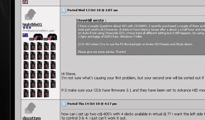

Prin apo kairo rwtise o aledjo giati o Fenderic exei 2 VirtualDJ licence ... kai surfarwntas to site vrika auto ...
Posted Thu 14 Oct 10 @ 5:51 pm
xaxaxaxxa
den einai dynaton.
ti egine? apoklietai na agorase tosa polla.
opos blepoume kai sti fotografia den einai to vdj alla to cue.
to cue polite sta katastimata kai exei to serial mazi tou.
apo kamia apothiki tha brike tosa polla serial.....
mporei na douleue se kanena tetoio magazi kai na tsakothike me to boss
kai tou eklepse ola ta serial.
de blepo alli logiki eksigisi
den einai dynaton.
Posted Thu 14 Oct 10 @ 6:14 pm
