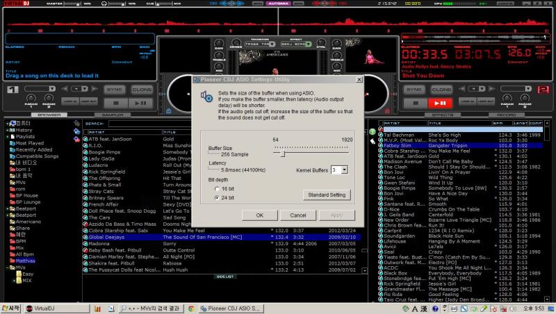

i'm having trouble setting up my cdjs in asio mode with vdj
everything is working fine in normal soundcard mode
i have 2 cdj 900s
latest firmware(4.20) & drivers(1.2)
tried it on two different computers(xp pro & win7 64)
followed instruction listed here
http://pioneerdj.com/support/product.php?c=2039&lang=en&p=CDJ-900&t=32
the problem is that i do not get another output option in the advanced config window
only "output 1&2"
no "output 3&4"
any help would be appreciated
thanx a lot,
matthias

Please open the Pioneer DJ ASIO driver utility and make sure that both decks are enabled.
Once you are sure that both decks are seen by the ASIO driver then start VirtualDJ and try again.

not sure if you meant this
both cdj are always displayed
but still not working
Posted Thu 14 Feb 13 @ 7:00 am
In the Advanced Sound Setup, do you get Pioneer ASIO once or twice ?
Posted Thu 14 Feb 13 @ 11:10 pm
only once
Posted Fri 15 Feb 13 @ 9:40 pm

Posted Wed 27 Feb 13 @ 4:07 am
Matt, try setting the bit depth on the CDJ ASIO setting screen to 16bit rather than 24bit.
