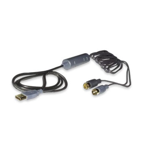

hi,
i\\\'m not sure i understand.
the controller might be native (so no mapper is needed)
but i have to make a connection between the djm 700 and the pc.
the back of the djm has a midi out like this
and the pc obviously has a usb port
i thought i needed something like this to make this connection.
i was wondering if some types or brands of these cables worked better with the djm than others

Almost any MIDI interface will work, but avoid the M-Audio UNO. We've had a few DJs report problems in using it with their DJM700's due to a chipset conflict in the interface.
Posted Tue 16 Mar 10 @ 3:59 pm

ok thanks i'll avoid the uno
