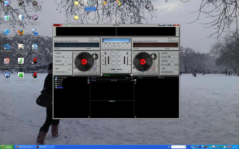

Ok the internal mixer interface skin tries to maximise the screen straight away and everything gets messed up.
The new HE5 interface opens up to the window setting and doesn't distort. However the window is small in relation to the big screen.
![](/image/94297/8686/desktop.JPG)
Any idea how to change this?

Anyone know how I can change this window size without maximising the window?
Posted Wed 18 Feb 09 @ 4:59 am
Download the screen resizer program under the plugin section. Select the xml file of the skin you want to use and set the new screen size to 1900x1050. Always set the horizontal size lower than actual screen size. This will allow you to get full screen image in a windowed mode. As previsously stated, it is best to run VDJ in a window. Hope this helps.
Posted Mon 02 Mar 09 @ 11:43 am
Or get a skin that matches your screen resolution. Resizing a skin from 1024x768 to 1920x1200 will not be pretty!
Posted Mon 02 Mar 09 @ 4:44 pm
