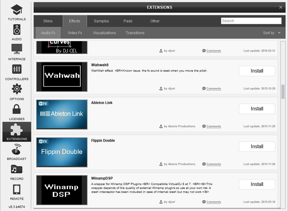

Hi
Did you remove the plugin as i'm not able to find it at the place you told :
inside the program option/extention/effect/audio
thanks in advance
thanks in advance
Posted Thu 15 Nov 18 @ 3:50 pm
It's still there
![](/img/279505/52414/AbletonLinkExtensions.png)
.. but you are probably not in Early Access Build
Posted Thu 15 Nov 18 @ 3:54 pm

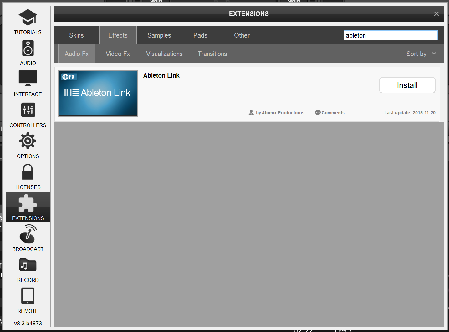

Dev staff wrote :
![](/img/279108/846/Screenshot_1.png)
Bronsi98 wrote :
Hello,
I can't find the plugin on the website or the Software anyone got a link or something?
Best Regards!
Best Regards!
I am unto find it also. I downloaded for my mac last night and now trying to install in my PC and it just dissapered!!!!
Posted Fri 22 Feb 19 @ 1:27 pm

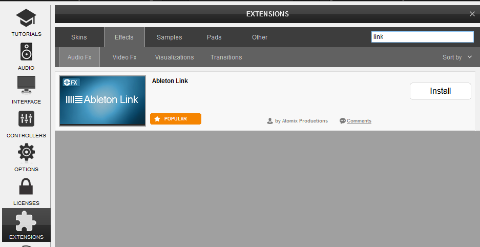

groovindj wrote :
It might be related to what Ableton told me recently.
I was think about you post about it, but I still see it in my extensions
![](/img/287216/40396/Capture.png)
Of course Link is a build into VDJ, so "install" really just means "enable"
Posted Sat 23 Feb 19 @ 1:45 pm
