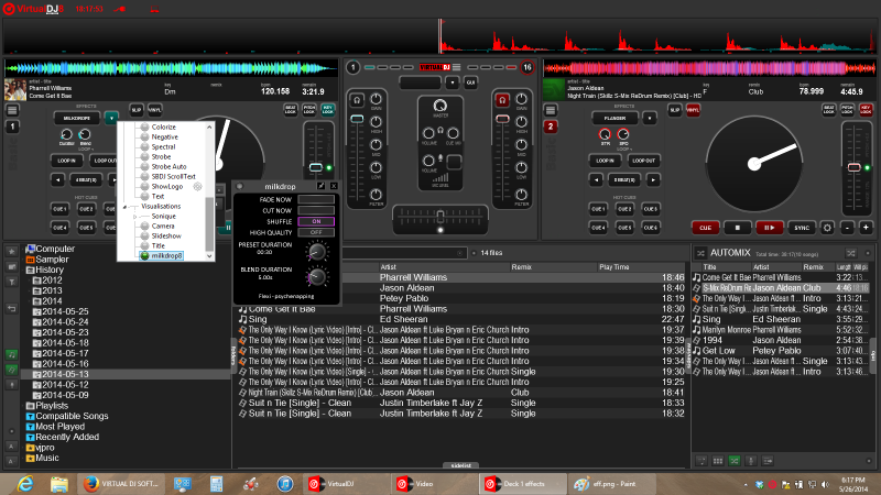

Even though it is lit up in the drop down
Posted Mon 26 May 14 @ 5:19 pm
Now how I get it to work is this. Load vid to 1 and audio to 2 no matter what at this point you cant control it. The minute you load another mp3 to deck 1 you can now go to master and select milkdrop and its lit up in the tree. I then open the gui and unpin it and move it. If I go on and mix adding videos and audio I will retain the control from the opened gui.

discobrian24 wrote :
Also you will notice that there is a mp3 loaded on 1 and a video loaded on 2. The milkdrop gui that is showing is from deck 1 and has no control over the effect ie. cant make changes.
I've tried this but am unable to replicate your issue; no matter where I open the GUI from the controls still work. Any chance of a 'process' so I can replicate?

Funny today I can not replicate.. hmmm
