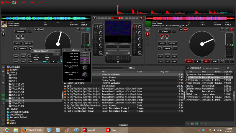

This is what I am talking about
Posted Mon 26 May 14 @ 5:16 pm
Also you will notice that there is a mp3 loaded on 1 and a video loaded on 2. The milkdrop gui that is showing is from deck 1 and has no control over the effect ie. cant make changes.
