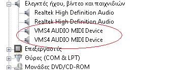

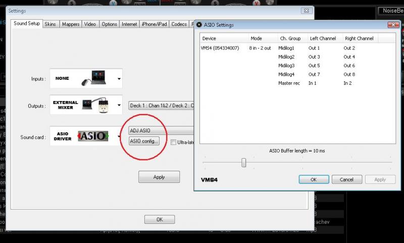

Kati paizei me tin egkatastasi twn drivers.
Sto Hardware Manager vlepeis tin VMS4 stis syskeues ixou?
An epilekseis setup ixou me external kai ASIO, patwntas to ASIO config, sou vgazei to diplano parathyro?
Otan tha mporeseis na tin setareis, prospathise na tin vazeis panta sto idio USB.

djdad wrote :
Vlepeis ta ledakia sto volumes tis VMS4 na anaboun otan paizei tragoudi? Sta akoustika exeis ixo otan epilekseis kapoio CUE ? An gyriseis to CUE MIX se thesi Master, akous tin eksodo?
ne fainontai ta leds sto volume. otan giriso to cue mix sto master den akougete tpt.
na s po pos ta dokimasa tora:
input:none
output:headphone
soundocard: mvs4
vms4:4out
otan pezi to dexi deck akouo sta headphones k apo to channel 2 kai 3
otan pezi to aristero deck akouo sta headphones mono apo channel 2
k stis 2 periptosis apo to channel 1 akougete distortion
Posted Tue 01 Feb 11 @ 10:41 am
An diavases to link pou eixa grapsei pio panw se parapempei se allo Sound setup. Mporeis na to dokimaseis?
Diavase prosektika step by step, des kai tin teleutaia protasi.
To ksanagrafw, na min psaxneis. http://www.virtualdj.com/homepage/djdad/blogs/4316/VMS4_Setup_Guide.html
Erwtisi, apo ti stigmi pou den exeis inputs. giati den tin trexeis se 8out mode?
Se 4out-4in mode douleuoun mono ta mesaia chanels, ta opoia prepei na exeis gyrismena kai se USB. Ta 2 akriana den douleuoun me to VDJ, mono analogika. Mono se 8out mode mporeis na oriseis se opoio chanel theleis opoio deck, apo 1 mexri 4.
An xreiasteis input gia recording, ginetai kai se 8out mode.
Genika ta 4in04out xreiazetai mono an exeis timecodes inputs, i ixografisi apo ekswteriki pigi.
