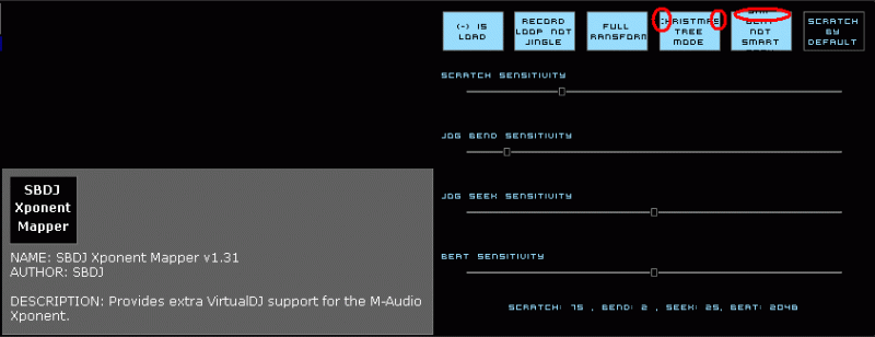

Available the version "1.31"
to download (pro user only):
http://www.virtualdj.com/addons/tools.html
Here a little text visual problem but is only cosmetic.
