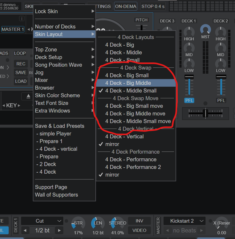

I have a question on waveform order (scratch mode), with 4 decks.
I only have fixed options (1234, 3124 etc...), but I've seen once the order could swap.
Can't find back where to set this swap option.
Any idea where I can set the swap in order to have the wave stack reordering automatically to always have both waveform playing touching together ?
Thanks!

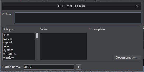

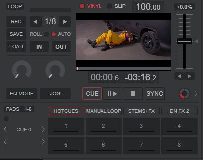

how to make one edit button change jog to video player . thanks
cdpanos wrote :
Fantastic work. Thanks
Hi,
test this :
toggle '@$jogvid_23'

The swapping Waves are only available on the swap Layouts.

Hi
Work perfect. Thanks

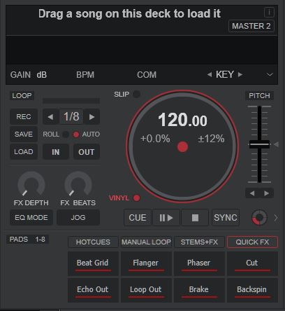

i want another two edit button (from this skins knob adjust fx depth and fx beats of the selected effects. Thanks for your help
This is not a question about the skin.
Better you ask in the general forum.

here a tip
Slider 1
Action effect_slider 1
Name `get_effect_slider_label 1`
Slider 2
Action effect_slider 2
Name `get_effect_slider_label 2`

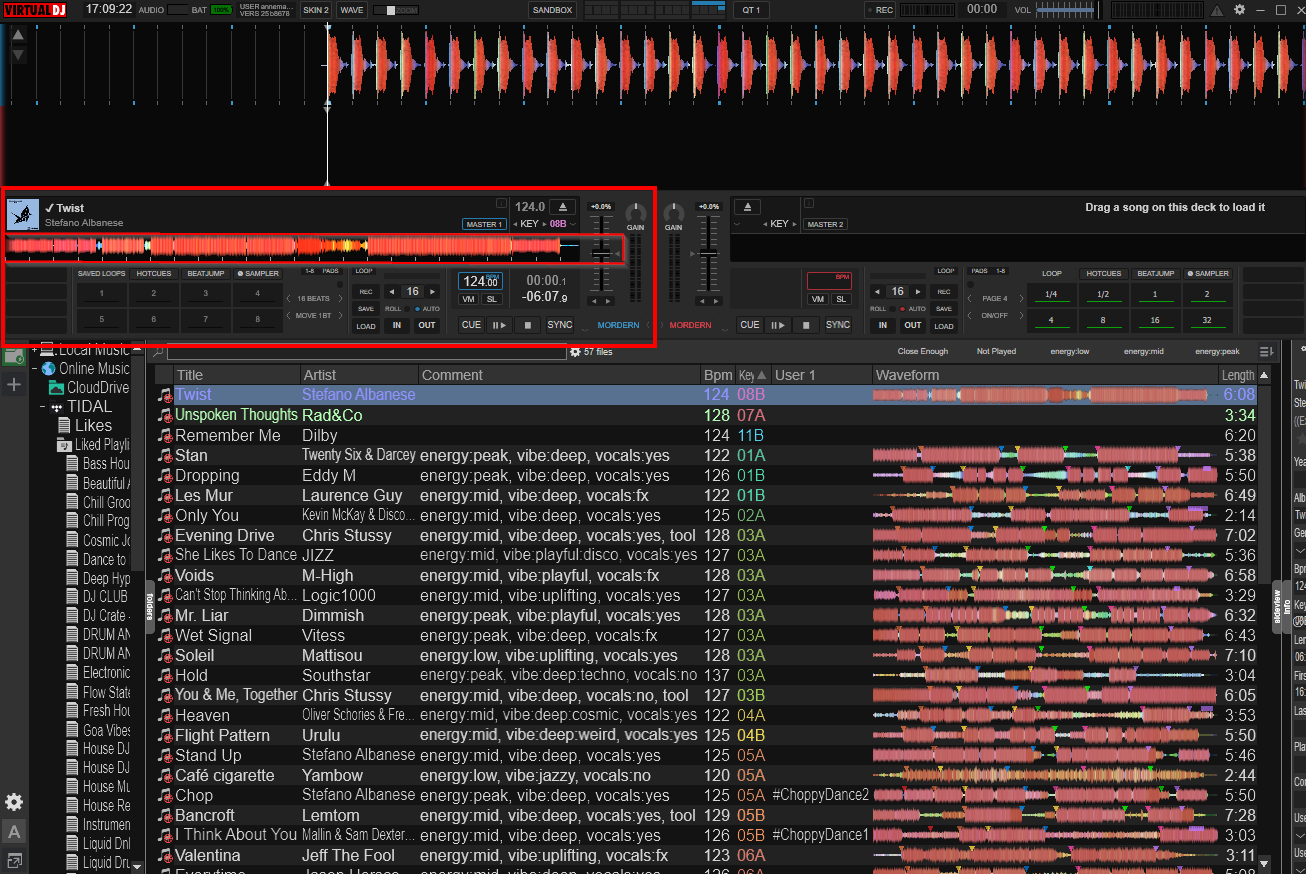

Heyo, first of all I really love this skin! Thanks for the great work! Its so customizable and clean looking. And I LOVE the beatgrit markes in the song preview waveform on each deck. That helps so much, especially when I started.
Now I have a question. I have never edited a skin, but since I will be getting a laptop soon, I was wondering if there can be some changes made to it, to use the space on the small screen a bit better.
Can i make the marked area of decks 1 and 2 bigger, so everything is easier to see? I can have smaller library, or just pop out the library when I need it.
Also the song preview could be bigger and also go longer (if not too difficult), to use the complete half of the screen.
I would be so happy if I could make the deck areas bigger. Maybe I also need an XXL waveform as well, but for now the decks and song previews worry me the most about the small laptop screen.

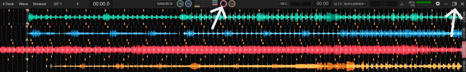

When using a 4-deck layout (any 4-deck layout) combined with the "beatcounter 4 circle,"
the current beat is displayed inside the circle for each deck, however, on deck 2, that number is shifted to the right, appearing in the top-right corner between the maximize and close system buttons...
I think a screenshot will make it clearer...
[Mod note first line of code was read as BBcode, and broke post, fixed]
I should mention that I checked the skin.xml file and think I found the potential error, but fixing it didn't actually resolve the issue.
<deck deck="[a letter B]">
<visual class="beatbar4" x="+62" y="+10" width="20" height="6" source="goto_bar 1"/>
<visual class="beatbar4" x="+8484" y="+10" width="20" height="6" source="goto_bar 2"/>
<visual class="beatbar4" x="+106" y="+10" width="20" height="6" source="goto_bar 3"/>
<visual class="beatbar4" x="+128" y="+10" width="20" height="6" source="goto_bar 4"/>
<visual source="get_beat_counter" type="circle">
<pos x="+27" y="+3"/>
<size width="27" height="27"/>
<off shape="circle" color="textcolorgreyoff"/>
<on shape="circle" color="buttonon"/>
</visual>
I tried changing <visual class="beatbar4" x="+8484" to x="+84"
but the bug was not corrected, I hope you can help us correct it.
Thank you so much
