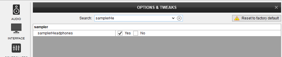

I just bought the MCX8000 and for some reason the sampler will play in my headphones but not over my speakers. Does anyone know what would cause this?
Sampler in Headphones : You can disable it by setting SamplerInHeadphones to No (from VDJ Settings->OPTIONS tab)
For sampler Ouptut on Master, make sure the SAMPLER VOL knob is not at minimum level position.
http://www.virtualdj.com/manuals/hardware/denon/mcx8000/layout/mixer.html (Nr. 16)

Awesome! Yes, I didn't see the Samplerheadphones option at first. You actually have to type it in. But now it works as I would like it to. Thanks for your help!
