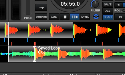

Some new loop problems: Smart loop not working and loop goes back by itself
try this:
1.turn on smart cue
2. turn on smart loop
3. load song and store a 8 beat loop and a hotcue at SAME place
start song and play stored loop.
1st bug:
press a button with stored loop --> Smart loop will not work!
2nd bug:
while the stored loop will play, press the hotcue button you have stored on the same place as the loop.
press 3-5x and look at the loop_in point on waveform. It goes back by itself. (see pic - bottom waveform)
3rd bug:
while the stored loop will play, press a empty hotcue button (emty slot) and jump to this Hotcue
The new hotcue set a new loop in point. This is imho not correct, too
try this:
1.turn on smart cue
1st bug:
2nd bug:
3rd bug:

djnice :o) wrote :
1st bug:
1st bug:
Smart Loop works here. What do you expect when Smart Loop is enabled ? Smart loop simply will trigger a loop at the nearest beat length if Loop In and Loop Out (manual loop) are used. The Smart Loop is not offering "Snap to beat" functionality.
And just in case you meant Smart CUe.. of course it wont work if you use the LOAD Loop button to trigger the Loop. Its not a hotcue point.
djnice :o) wrote :
2nd bug:
2nd bug:
Well, what it does here is that indeed the loop is a bit moved, but the Hotcue works as expected with Smart Cue (quantized) and if you leave the saved loop to go on, its still a seamless one. The graphic is indeed a bit confusing though.
djnice :o) wrote :
3rd bug:
3rd bug:
Setting LoopAutoMove ;)
