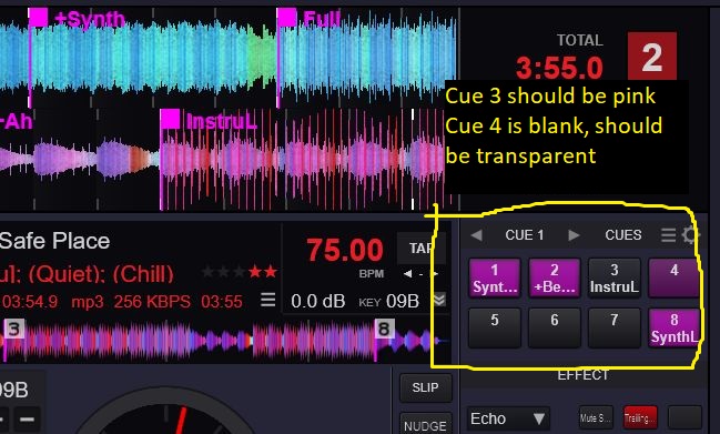

Hi all, have some issues with my V8 but by FRUIT skin (v0.8.2).
The hot cue buttons sometime take colors from other cues, even if they are blank. I know I tried to edit the cue button section in the Main.xml in the past, so I tried to reinstall the skin fresh, which reverted other changes I made, but this problem persists. Anyone has experience or insights on the problem and knows a way to revert the problem? Thanks!
Edit: Actually, the problem only occurs in the compact hotcue panel, not in the fully extended one where you see 9 hotcues.
The actually problem is that the color of hotcue 3 get overridden by the color of hotcue 7, and the color of hotcue 4 by the one from hotcue 8.

it would be highly appreciated if fruit does an update to iron out the issues with v2020..give him time..he will come around!
i have one request..probably anyone of you can help...for this i am simply just using the picture in the post above this with the color problem.
in that pic..the custom button on top the skin(not visible in the actual picture) are just above the part of the skin where they u can manually select the song position(just under 256 kbps in the pic).
it has not happened as yet,but im afraid one day i might mistakenly click the song position and the live deck will skip to the point(total disaster!) as my custom buttons are multi,so the options end up being on top the song position window...i hope u guys catch where i'm coming from..so i am looking for a solution to disable seeking from that song position window.
it can be in the form of a new setting in the config page/skin xml edit/or in fruit updated skin as an option edit in the future.
any help on this would be appreciated! thanks in advance
Posted Sat 12 Oct 19 @ 4:12 pm

no..here it is

Those buttons are nowhere near the songpos wave! I think you just need to be more careful with your mouse :-)
I just found an old post that suggests you could place a button element on top of the songpos with an action of 'nothing'.
Posted Sat 12 Oct 19 @ 5:13 pm

it's not the button itself, it's the different options provided by the button(like 0.475/5 in my picture)

Please - you do not need to quote everything from the previous message when it's directly above your own post!
I understand that your button menu drops over the songpos, but you just need to be careful :-) When you use the menu, stay to the right side.
Posted Sat 12 Oct 19 @ 5:36 pm
sorry..i didnt know..my humblest apologies! ok no problem...i will be careful..i do not ever really use the song position window so i was just considering the possibilities.
Posted Sat 12 Oct 19 @ 5:44 pm
Other than placing a button (that does nothing) over the songpos area, it might be possible to add a visibility option to the songpos, so that it does not show when the custom button is clicked.
Posted Sat 12 Oct 19 @ 6:22 pm
well i have no idea on how to do that so i think i will just stick to being careful with my clickings!
Posted Sat 12 Oct 19 @ 6:52 pm
