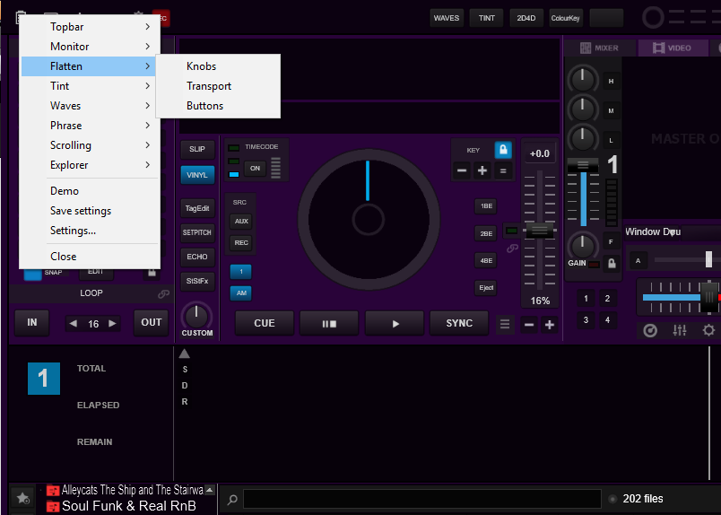

Getting weird things happening with the skin on the latest VDJ Build (4973)
Notably on the left deck (weird red surround), the phrasers, where artwork appears, where the clock & settings menus appear, (grey surround), the volume sliders & gain buttons have a weird gradient now too...
Running OS X 10.11.6. Scared to update to 10.14
Posted Thu 23 May 19 @ 3:05 pm

Looks to me the skin has reset everything to FLATTEN, Just uncheck them all

I want it to be flattened.
Turns out i had the 'Experimental Skin Engine' feature set to enabled. Disabled it and it fixed all issues.
