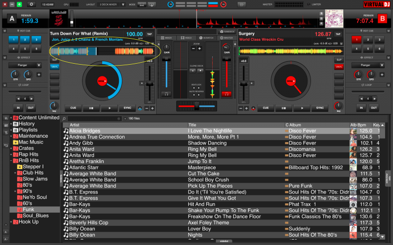

The corners of the pitch graphic are not completely clean smal white dots.
Prev.player stop playback always on one Track Stereo 44100Hz 32bit Bitrate 254 mp3
