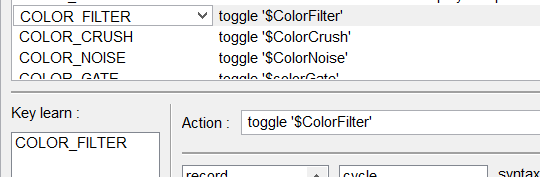

Ok heres what the mapping on my Pioneer DJM 850 looks like,
Ok so when I press this button it resets my filter but I want the first parameter knob on VFilter to reset to 50% when I press this button. I cant seem to make it work so any help is appreciated.

Nope that did nothing.......
BUT
I just got it, toggle '$ColorFilter' & deck 1 effect_select 'VFilter' & effect_slider 1 50%
Thanks for time Loco.
BUT
Posted Mon 05 Oct 15 @ 3:29 am
Or even shorter: toggle '$ColorFilter' & effect_slider 'VFilter' 1 50%
PS: I'm not sure that you really want to use deck assignment on your script.
Posted Mon 05 Oct 15 @ 5:51 am
Only seems to work on deck 1. I need it to work on all decks [1-4].
Then you have to go the "hard" way:
toggle '$ColorFilter' & deck 1 effect_slider 'VFilter' 1 50% & deck 2 effect_slider 'VFilter' 1 50% & deck 3 effect_slider 'VFilter' 1 50% & deck 4 effect_slider 'VFilter' 1 50%
how about
toggle '$ColorFilter' & repeat_start_instant "rsiResetVFilter" 33ms 4 & effect_slider 'VFilter' 1 50% & select
Same result, isn't it?

locodog wrote :
how about
how about
It depends on your other mappings and stuff.
Generally speaking switching the "selected" deck via this type of scripts should be avoided.
If a user has actions that follow the selected deck it could create issues. Also, "select" switches "pfl" as well.
On this particular case I guess it should work without any issues. But generally speaking you should always consider the side-effects of the script commands.
