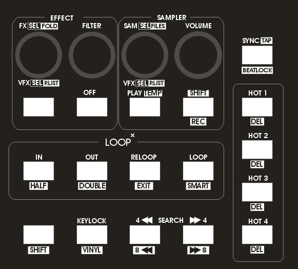

Exw ftiaksei Definition File kai Mapper me polles leitourgies. Opoios thelei na dokimasei tou stelnw beta. Apeuthynomai vevaia se katoxous VMS4, pou apo oti thymamai, enas akoma yparxei, i yparxei ki allos?
Posted Sat 13 Nov 10 @ 10:43 pm
O mapper (+Definition File) tha einai diathesimos edw meta apo tin egkrisi tou Team
http://www.virtualdj.com/addons/12221/American_Audio_VMS4_Pro_Full.html
Etoimazw kai skin (derma) gia tin VMS4 me vasi ton mapper kai tis nees allages.
Graphics Preview
Graphics Preview
Posted Sun 14 Nov 10 @ 5:42 pm
