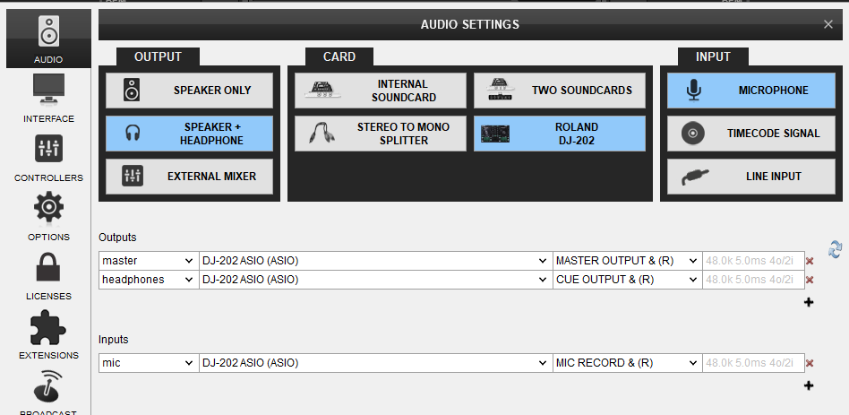

The Roland DJ-202 offers a Microphone Input at the rear panel to connect your Microphone. The signal of this input is routed directly to the Master Output (rear panel socket). However, a special USB Audio Input is offered to also pass the signal of the Microphone Input so that it can be recorded along with your mix.
This input is already pre-configured in the Audio setup of the Roland DJ-202, when the special button at the top is clicked.
In order to record the Microphone Input along with your mix, the MIC ON button needs to be enabled at the MASTER mixer panel of the default VirtualDJ GUIs.
