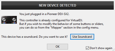

A Device Detected window will appear next, to verify the proper detection.
Click on the DDJ-RX button and VirtualDJ will automatically create and apply the default audio configuration using the built-in audio interface of the device
Click to OK
The unit is now ready to operate.

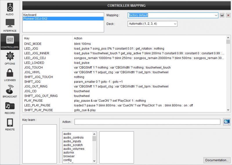

MIDI Operation
The unit should be visible in the MAPPING tab of VirtualDJ Settings and the “factory default” available/selected from the Mappings drop-down list. The factory default Mapping offers the functions described in this Manual, however those can be adjusted to your needs via VDJ Script actions.
Find more details at VDJ Pedia

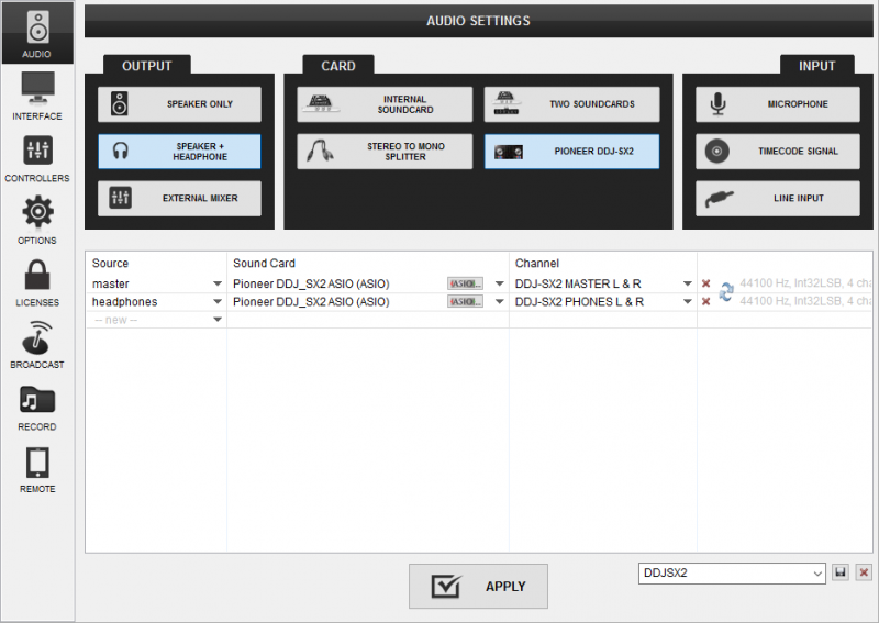

Audio Setup
The unit has a pre-defined Audio setup and a special button in the AUDIO tab of Config to provide that. Alternative Audio setups can be applied in the same window. See Advanced Setup
For further software settings please refer to the Manuals of VirtualDJ. Layout
